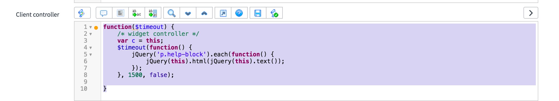

Hi Brian,
I checked this issue and found that the   problem was with the page load time so I added timeout function which will get execute after 1.5 seconds.
Please find below updated script :
function($timeout) {
  /* widget controller */
  var c = this;
  $timeout(function() {
  jQuery('p.help-block').each(function() {
  jQuery(this).html(jQuery(this).text());
  }, 1500, false);
