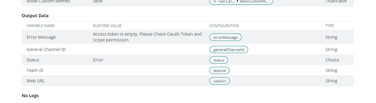

I am having an issue with the access token in an action for flow designer
Samuel Moya cam
Hi, I am having an issue with an action in flow designer, the error message says the access token from microsoft teams is empty, I checked it and it´s not. So any recomendations to follow?
Thank you.
Samuel Moya cam
Hi, the problem was already solved.
So actually the problem was solved gettin a new OAuth Token, this is because the token was about to expired.
Thank you and best regards.

Hi Samuel,
Please could you check whether the credentials are OK, if the Oauth token is passed to the API request correctly. The last possibility is that the output variable is not mapped to the step output.
You can go through each step execution details to verify what is received and what is sent as an output.
Maybe you could attach the step execution details?

Hi, I checked all the steps and see that the create Team [REST] credential is empty, it shouldn´t be empty because just the action above this one isn´t empty, and I don´t know how to configure it.

Samuel Moya cam
