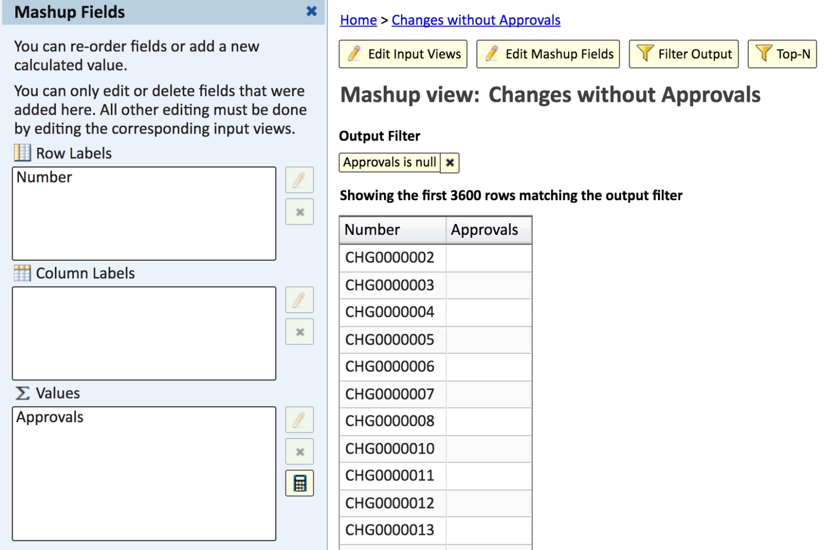

If in future you want to define these kinds of reports without building a database view, you can use Explore Analytics to compare records on any two (or more) tables using the Mash-Up capability. It looks like this:
1) Create a report with the Approvals, grouped by the associated change request:
(note: I relabelled the 'Approval For' field to 'Number' just for this report, for the mash-up to work)
2) Create a report with all of the records on the change request table:
3) Create a 'Mashup' view by selecting those two reports:
Now you'll have a report that shows all of the changes, with the number of approvals (if any):
With a right-click, you can filter on only the records that have no approvals:
Now you can see any of the records on table A (change_request) that are not on table be (sysapproval_approver).
This report is live, drillable, and can be embedded in ServiceNow or any non-ServiceNow portal.
