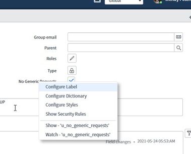

It's running on the Configuration Name Field (configuration_name) on change that goes the CI's and it's auto populating the Support Group (support_group) of the CI. But I don't want it to populate if that u_generic_service_requests is true. TIA
