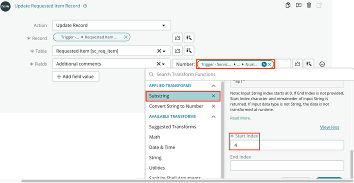

Can you show your configuration?
Please compare it with this (working) example:
Note that the applied transformations are as follows:
1.) Substring (Start Index=4, Leave End Index empty)
2.) Convert String to Number (No arguments)
ā05-18-2023 02:17 PM
var a = fd_data.trigger.request_item.number.toString();
var cid = a.substr(a.length - 7);
gs.info(cid);Note: You can perform this using a string transformation in the flow designer, no scripting needed.
Note2: If you only want "skip" the "RITM" and the leading zeroes, you can also accomplish this by using flow designer transforms: 1.) substring to remote the RITM 2.) cast to integer (this will automatically remove the leading zeroes) 3.) cast to string again.

Thank you that was helpful. Using transform functions makes sense. Both the number field and my custom field are string fields, so it seems like just the substring function would be enough without converting to a number then back to a string? But when I use the string transform with start index 4 and end index null and test it I get an "is not a valid record." error.
ā05-18-2023 10:18 PM
