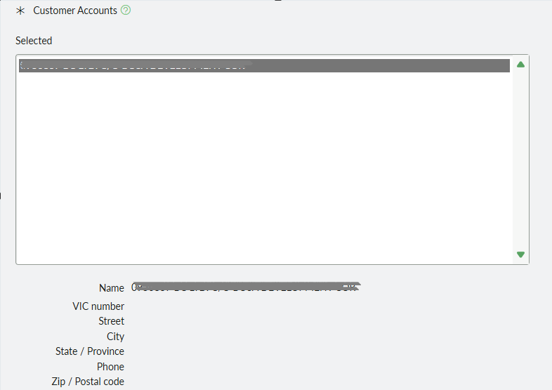

I need to customize the fields that shows below the list collector on RITM and SC Task.
Charutha R
I need to customize the fields that shows below the list collector on RITM and SC Task. I have tried to configure it from the reference table (list collector reference table), Configure --List layout but it still shows the same fields.
2 ACCEPTED SOLUTIONS
Ankur Bawiskar
@Charutha R
you can configure view "sys_ref_list" on the table being referred by list collector and then add/remove fields
How to configure the fields shown after clicking an item in a list collector (slushbucket)
Customizing the information displayed below the list collector catalog variable (slushbucket) after ...
