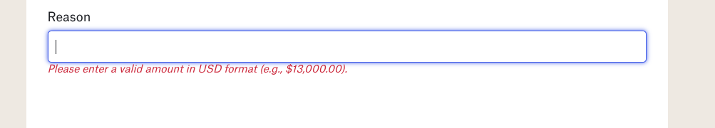

Can you try using this on-change client script on the field
// If the form is loading, don't validate
if (isLoading) {
return;
// The value of the field being validated
var value = newValue;
// Regular Expression to match the US currency format: $13,000.00 or 13,000.00
var regex = /^\$?\d{1,3}(,\d{3})*(\.\d{2})?$/;
// Test if the value matches the regex
if (!regex.test(value)) {
// Show an error message if the value does not match the pattern
g_form.showFieldMsg('your_field_name_here', "Please enter a valid amount in USD format (e.g., $13,000.00).", "error");
g_form.setValue('your_field_name_here', ''); }
}- Thank you ,

03-12-2025 02:42 AM
Hi @niveditakumari
if (isLoading) {
return;
}- Thank you ,
Sohail Ahmed Syed
