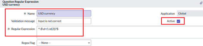

Juhi Poddar
Hello @niveditakumari
Follow these steps:
  • Navigate to All -> Variable Validation Regex
  •  Create a New record and add Regular expression ^\$\d+(\.\d{2})?$ JuhiPoddar_2-1741773448047.png
  • Add this Regex to the variable in type specification sectionJuhiPoddar_3-1741773625454.png
Note:
  • This ensures the field only accepts values starting with $
  • Now, users must enter values like $1000.00 or $1000 and incorrect formats (e.g., 1000.00 or 1000) will not be accepted.
Hope this helps!
