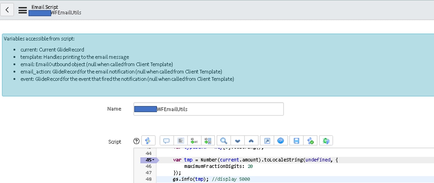

I want to add a comma to the Decimal type amount in a server-side script (EmailScript) and display it in the body of the email.
<Example: Amount: 5000 ⇒ 5,000>
As shown below, I have described a script that adds commas to Decimal type amounts, but commas are not added.
I want you to tell me the solution.

In server-side script (EmailScript), the following method to put a comma in the amount was not available, but it can be used in Client script.
What is the difference between the two?
<Method with comma>
toLocaleString (undefined, {
maximumFractionDigits: 20
