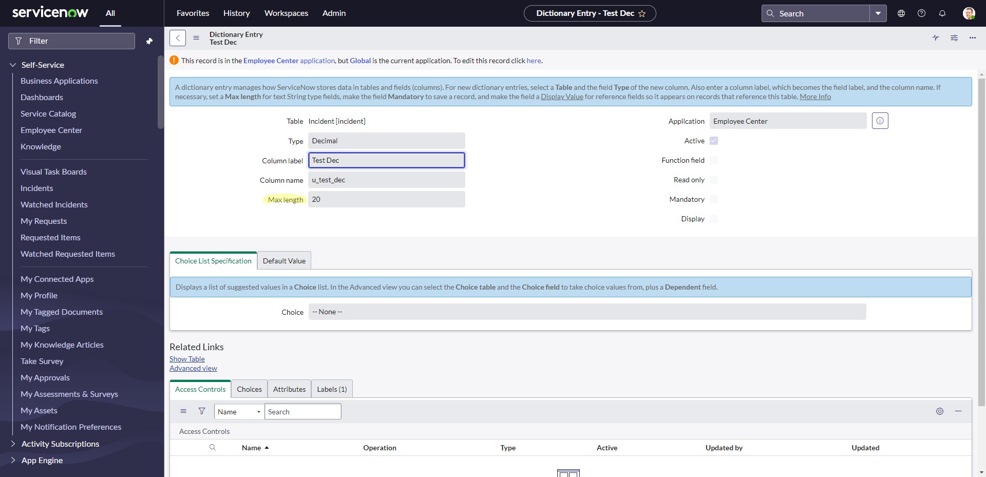

I created a table in application scope and added a VALUE field. The type is a floating point number.
Is it possible to set the maximum number of digits that can be entered to 14?
Please follow these steps.
Right click on your field label and select configure Dictionary
If you dont have the field on the form it can be different view you are seeing you can change a view but I am not sure thats the problem here So
Right click on header select Configure > form layout
Then find Max length field in available bos and bring it to selected and save the form and than go to form and set the length

Please set Max lenth in dictionary. If that doesn't work you can use Client script for max length validation.

Hi.
How can the Max length field be displayed?
I checked the dictionary but could not find the Max length field.
***Mark Correct or Helpful if it helps.***
The Max length field appeared and setting the maximum number of digits worked fine.
Thank you.
