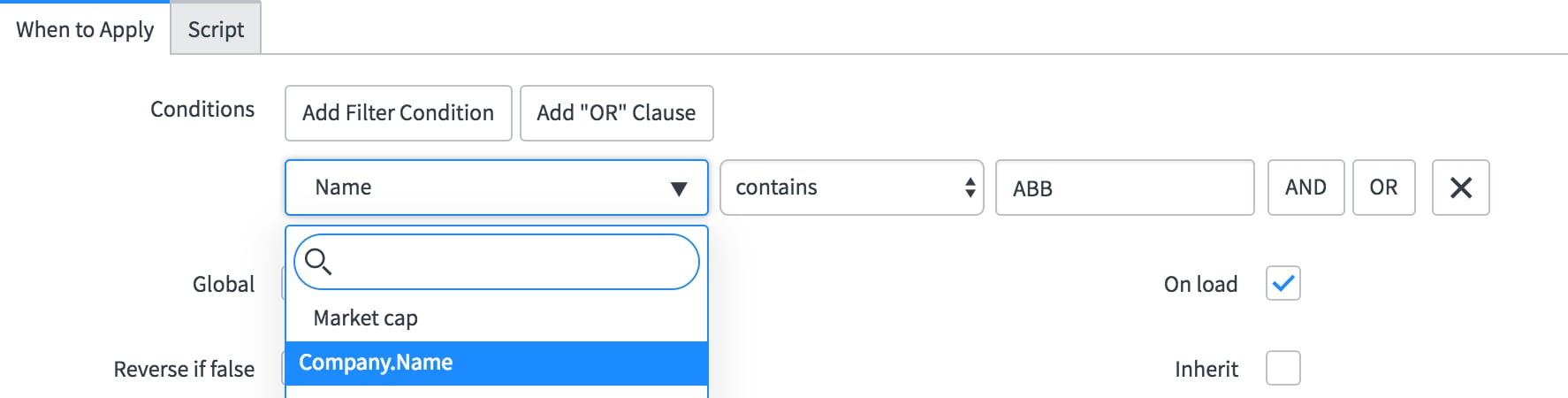

If so, may be try this script: (In the script part of a UI policy - this way you only need the script in one place and prevents writing the same script twice, onLoad and onChange)
UI Policy When to run:
Dot-walk to the Name of the Company. (If you select show related fields, it shows the related fields of all reference field) and choose 'Contains' and give your phrase.
...here's the script part:
