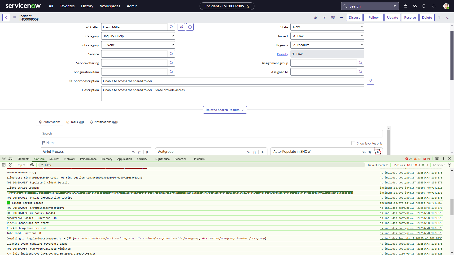

Hi @Ankur Bawiskar

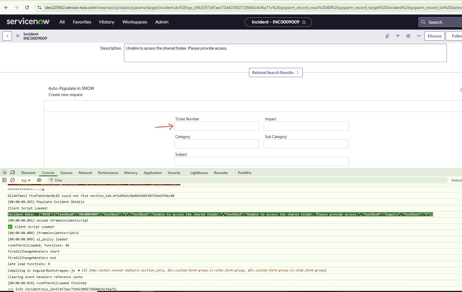

I have attached the screenshot where if you would see I am able to get the incident number, subject, description etc. using the script I have written attached image.
The iframe is also loading correctly.
Now when I press the button highlighted in red in the attached image , then the incident data should be auto -populated in my form ( image attached).

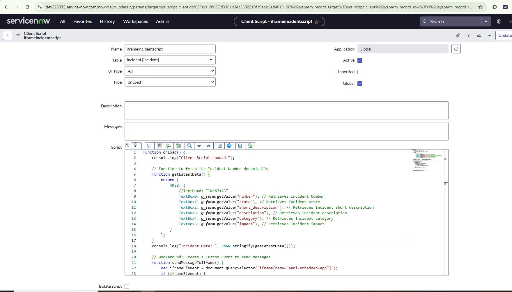

Script i have written :-
function onLoad() {
    console.log("Client Script Loaded!");
    // Function to fetch the Incident Number dynamically
    function getLatestData() {
        return {
            4938: {
//TextBox0: "INC67123"
                TextBox0: g_form.getValue("number"), // Retrieves Incident Number
TextBox1: g_form.getValue("state"), // Retrieves Incident state
TextBox2: g_form.getValue("short_description"), // Retrieves Incident short description
TextBox3: g_form.getValue("description"), // Retrieves Incident description
TextBox4: g_form.getValue("category"), // Retrieves Incident category
TextBox5: g_form.getValue("impact"), // Retrieves Incident impact
    console.log("Incident Data: ", JSON.stringify(getLatestData()));
    // Workaround: Create a Custom Event to send messages
    function sendMessageToIframe() {
        var iframeElement = document.querySelector('iframe[name="aari-embedded-app"]');
        if (iframeElement) {
            console.log("Iframe found, sending message...");
            var mappedHostData = getLatestData();
            iframeElement.dispatchEvent(
                new CustomEvent("sendAariData", {
                    detail: { data: mappedHostData[4938] }
        } else {
            console.error("Iframe not found!");
    // Delay to allow the iframe to load before sending data
    setTimeout(sendMessageToIframe, 1000);
You can check & resolve it( listener seems most likely the issue)
Hi @Ankur Bawiskar
The code below is the listerner issue, the red button that i click highlighted above image , the ID of that process is mentioned a "4938". which means when i click on that process it should auto fill my form , form is attached in previous message image
 return {
            4938: {
@Aditya007aa
I don't think using onLoad client script you can access the elements within iframe.
whatever needs to be done should be within the widget
