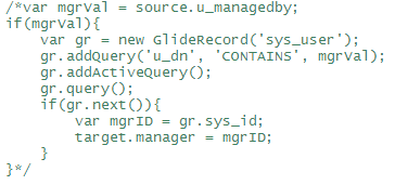

So the second modification that I made to the transform script, was to run a GlideRecord to the user table, find the user who has a DN that matches the DN of the manager of the group record, get that sys_id and set it as the value for the manager field on the group record. That script is here...
so the end result using this method is the same. I end up with several hundred empty user records with the exception of that u_ad_display_name field which contains the DN for that user.

I think I've solved this problem. In my transform map, the u_member field of the import set table was being mapped to the u_member field of the group record. Well, the u_member field of the group record is just a text box, it won't actually do anything. For some reason this was being used to try and add members to the group which it couldn't find any users with a sys_id that matches a CN from AD. So it would create empty records and insert that value as the only value for the user. Removing that field mapping from the transform map seems to have resolved the issue for me.
This is the second time i've found this to be the issue because if you do the same thing for the manager field on a user import that is going to the sys_user table, it may do the same thing. I removed the a similar mapping from my user import and it fixed it for that import as well.
