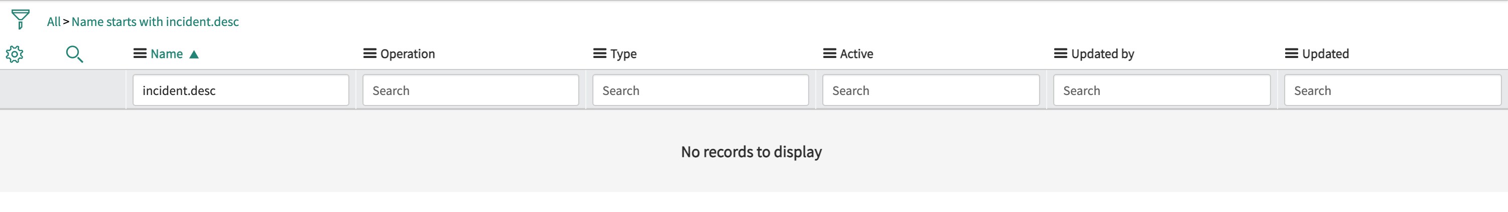

ACL which was deleted -
NO ACL for description -

So if there is no ACL for table.field, but the table is extended from another table, and that field derives from this other table...then it will use that parent table's ACL for that field (if applicable).
With that said, there is an ACL for task.description which requires: itil or task_editor roles to edit it.
So either create a new write ACL for the incident table.description and adjust role and/or condition as appropriate or consider revising this one that is out of box, but I would suggest against doing that.
You can also debug security rules yourself as that end-user (impersonate) and see that they'd be unable to write to it: https://docs.servicenow.com/bundle/quebec-platform-administration/page/administer/contextual-securit... and why.
