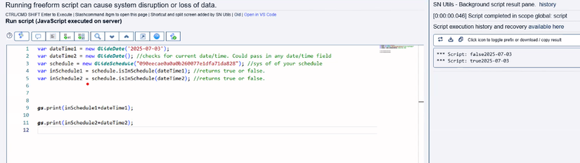

I'm trying to verify whether a specific date falls within an existing schedule in ServiceNow. However, I'm seeing different results depending on whether I manually input the date or use GlideDate() to get the current date. Here's the script I'm using:
var dateTime1 = new GlideDate('2025-07-03'); // today's date
var dateTime2 = new GlideDate(); // Retrieves the current date
var schedule = new GlideSchedule("090eecae0a0a0b260077e1dfa71da828"); // sys_id of my schedule
var inSchedule1 = schedule.isInSchedule(dateTime1); // Returns true or false
var inSchedule2 = schedule.isInSchedule(dateTime2); // Returns true or false
gs.print(inSchedule1 + dateTime1);
gs.print(inSchedule2 + dateTime2);
Output:
*** Script: false2025-07-03
*** Script: true2025-07-03
As you can see, both dates appear the same (2025-07-03), but the isInSchedule method gives different results. I'm trying to understand why this happens. Could it be due to time values not being set in GlideDate, or is there something else I might be missing?
Any insights or suggestions would be appreciated.

Hi @rishabh jain3 , The problem is with your current code is that the isInSchedule() method expects a date and time.
Here is breif information:-
The issue in your code, resulting in false for dateTime1 and true for dateTime2 even though they represent the same date (2025-07-03), lies in the type of object you are passing to schedule.isInSchedule() and the time component implicitly or explicitly associated with them.
Here's a breakdown:
You are creating a GlideDate object. A GlideDate object only stores the date component (year, month, day). It does not contain any time information.
When you pass dateTime1 (a GlideDate object) to schedule.isInSchedule(), the system might default its time component to 00:00:00 (midnight) for the purpose of checking against the schedule.
If your schedule "090eecae0a0a0b260077e1dfa71da828" does not have an entry for 2025-07-03 at precisely midnight (or if midnight is outside its defined working hours for that day), isInSchedule() will return false.
You are creating another GlideDate object, but this time you are initializing it without any arguments. When initialized this way, new GlideDate() retrieves the current date.
Crucially, when isInSchedule() is called with a GlideDate object that represents the current date, it often implicitly uses the current time for the check.
Since it is currently Thursday, July 3, 2025, at 9:32:32 PM IST, and assuming your schedule has active hours at this time on July 3rd, isInSchedule(dateTime2) will likely return true.
‎07-03-2025 09:05 AM
the method works with GlideDateTime object and not with GlideDate
try this
var dateTime1 = new GlideDateTime('2025-07-03 00:00:00'); // today's date
var dateTime2 = new GlideDateTime(); // Retrieves the current date
