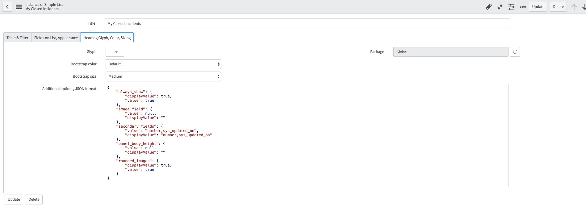

So I tested this morning by creating a similar widget called 'My Closed Incidents' like in screenshots below:
I then closed over 10 test incidents for a test user and then change the max value to 10, see result below:
I went back and changed it again to 5, and still worked:
If you lower your max value to less than 20, does it work? Or it's not working for anything else than 20? Would you be able to include some screenshots of your widget?

I've changed the value to 22 and still worked. Then changed to 24, still worked (had 25 closed incidents), then change to 30 and still worked (all incidents were shown). At this stage I believe the property works, there might be something else in your case that is restricting it.
