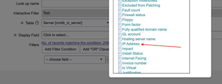

I'm trying to make a filter available for my user, the table being shown on the report is cmdb_ci_server and and not being able to create an interactive filter to filter by IP Address
This field type is "IP Address (Validated IPV4, IPV6)" is there any restriction to use it as a filtering option?
Najmuddin Mohd
Hi @Vinicius Luz1 ,
Yes, actually there is a restriction OOB.
But, you can modify the attributes by adding it's type in the attributes by clicking Configure Dictionary.
ip_addr is the backend type name of IP Address.
Once done, you can see it
