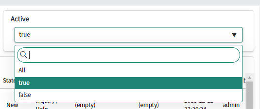

Hi @Ak8977 .
Ok, got it. You can't create interactive filters that will state this or this is true. You can only create interactive filters that state what should be true. This can be done by creating two interactive filters One for state and the other for active / inactive.
First:
Second:
Above two interactive filters will work together in collaboration.

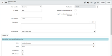

Hello @Ak8977 ,
1.)Create Interactive filter for state :

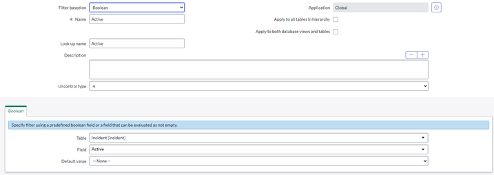

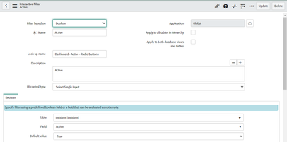

2.) Create Interactive filter for Active :

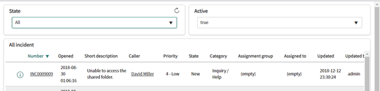

3.)Add that filter to the dashboard:
4.) Checked 'Follow interactive filter' of report.

11-20-2023 01:24 AM
Hi @Ak8977 ,
Please see my previous answer as this is not how interactive filters works. You can't create interactive filters that will state this or this is true. You can only create interactive filters that state what should be true.

Hi @Ak8977
I agree with my friend @AndersBGS here. Interactive filter works like State is This and Active is True.
