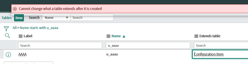

Table information is saved in sys_db_object table and the "Extends table" was not changed. Furthermore, if I try to change the "Extends table" column, an error message "Cannot change what a table extends after it is created" is displayed.
So in all, it's no longer possible to change the parent table.
