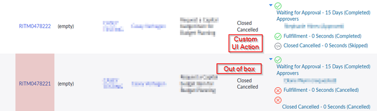

I am trying to replicate the logic of the out-of-box UI action on sc_request called "Cancel Request".
The logic in that UI action is pretty simple:
current.request_state = 'closed_cancelled';
current.stage = 'closed_incomplete';
current.update();I've created a UI action on the sc_task table using basically the exact same logic, except I'm querying the request because dot walking didn't seem to work:
var req = new GlideRecord('sc_request');
if (req.get(current.request)) {
req.request_state = 'closed_cancelled';
req.stage = 'closed_incomplete';
req.update();
Regardless of which UI action I use, the result is that the state and stage fields of the RITM are set correctly. But the way the stage is displayed in the list view is incorrect. You can see in the below image, that the red X indicates that RITM has been cancelled, vs the top request shows that fulfillment was completed and closed cancelled was skipped.
So something isn't quite behaving in the custom UI action like it does when using the out of box action, and I'm hoping someone might be able to shed some light on this, or at least point me in the right direction to figure out what I'm missing here.
TIA!

Are those two ritms the same catalog item with the exact same work/flow? Cancelled at the same point in the flow? And what do the flows look like?
Consider this oob flow, it's been cancelled with the ui action in stage order fulfillment while the task is still open.
Order fulfillment shows up completed and request cancelled step is skipped because the br will just cancel the flow and the flow stage will never happen so it is misleading.
I don't see any reason why the behaviour would be different from your ui action because they do exactly the same thing. Unless there is something else in the custom ui action of course
02-25-2026 05:11 AM
Yes, the two catalog items are the same. The workflow is pretty simple. Request submitted > Approval 1 > Approval 2 > TASK created. I'm cancelling after the task has been created.
02-25-2026 03:46 PM
Without access to your instance it's hard to say what is happening but it does not matter if you do the update from another form via this ui action.
There could be some customization that makes it only work as expected when the current.update() in the request ui action captures all the changes on the form which wouldn't happen from sc_task.
What happens if you just run this as a background script? If it works as expected then start looking in the sc_task side of things and if not then look into sc_request

05-12-2026 01:32 PM - last edited a month ago
I got pulled away for some other things but finally have a little bit of time to come back to this. Running it as a background script worked as expected. Code added below for reference.
The REQ state is closed complete, the RITM state is closed cancelled and the stage is request cancelled, and the TASK is also closed cancelled.
So it it works from the OOB UI action on the REQ, and when I do it as a background script, where would I start troubleshooting on the sc_task side of things?
EDIT: I take that back. I looked at the wrong record before and the stage doesn't appear correctly in the list view:
