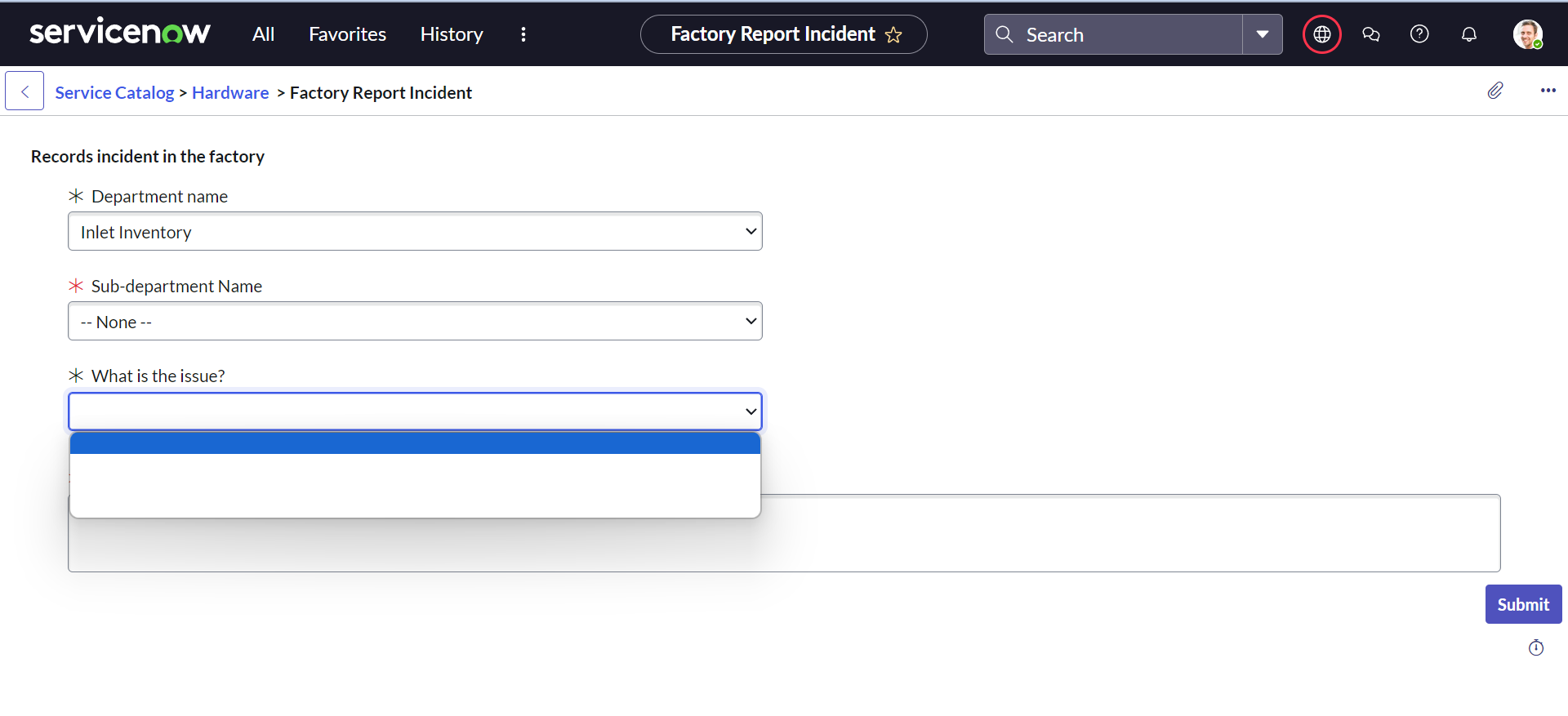

Hello Community,
Based on the situation I need to remove some options and add others in choice data fields depending on a parent field. To tackle this situation, I am clearing all options and adding specific options during onChange.
The issue is that when I am clearing or removing options and adding new ones, the options are added in the dropdown, but the text is not visible.
Below is the code:
        return;
    g_form.clearOptions('factory_issue');
    if (newValue == 'inlet_inventory') {
        g_form.addOption('factory_issue', 'out_of_stock');
        g_form.addOption('factory_issue', 'power_failure');
        g_form.addOption('factory_issue', 'internet_failure');
        g_form.addOption('factory_issue', 'storage_capacity_exceeded');
    } else if (newValue == 'manufacturing_department') {
        g_form.addOption('factory_issue', 'machine_issue');
Hi @Fiske
Because you're writing the options to show. Modify it as follows-
        return;
        g_form.addOption('factory_issue', 'out_of_stock', 'Out of Stock');
        g_form.addOption('factory_issue', 'power_failure', 'Power Failure');
        g_form.addOption('factory_issue', 'internet_failure', 'Internet Failure');
        g_form.addOption('factory_issue', 'storage_capacity_exceeded', 'Storage Capacity Exceeded');
        g_form.addOption('factory_issue', 'machine_issue', 'Machine Issue');

Hi @Fiske ,
I tried your problem on my PDI and I hope my solution helps you, please refer below code
if (newValue == 2) {
        g_form.addOption('state', 11, '6 - Really Low');
If you want to add option in dropdown fields you need to give both frontend name and backend name
You can do like this
Please mark correct and helpful if this works for you
