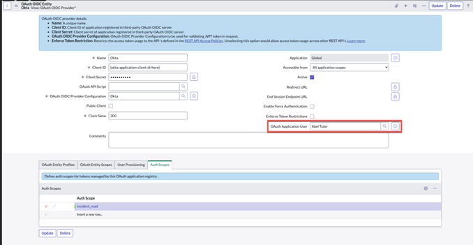

Here's my view in Application Registries:
As you can see I have a client-id and client-secret set here. Now:

Hi @ncastagnet_mc ,
The ServiceNow documentation for using grant type "Client Credential" for inbound requests looks a little different than your setup. You can find the setup here for more inforamtion: https://www.servicenow.com/docs/bundle/xanadu-platform-security/page/integrate/authentication/concep...
But it states as below when and how to use client credentials grant type:
Use the OAuth client credentials grant type for Inbound Integrations from a third party OAuth client to the ServiceNow® platform.
The administrators can use the client credential (CC) grant type to enable integration from a third party OAuth client to the ServiceNow platform.
Inbound client credentials grant type is a capability that can be controlled through a system property. By default the system property is false.
To use the client credentials grant type, you must perform the following steps:
- Create the glide.oauth.inbound.client.credential.grant_type.enabled system property.
- Add the OAuth Application User field to the OAuth Entity form.
