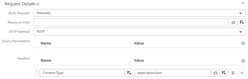

As noted in the post by Ihor you can make a GraphQL call using an action with a REST Step and giving it the Header "Content-Type" : "application/json". Then all you have to do is pass the body in JSON format.

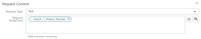

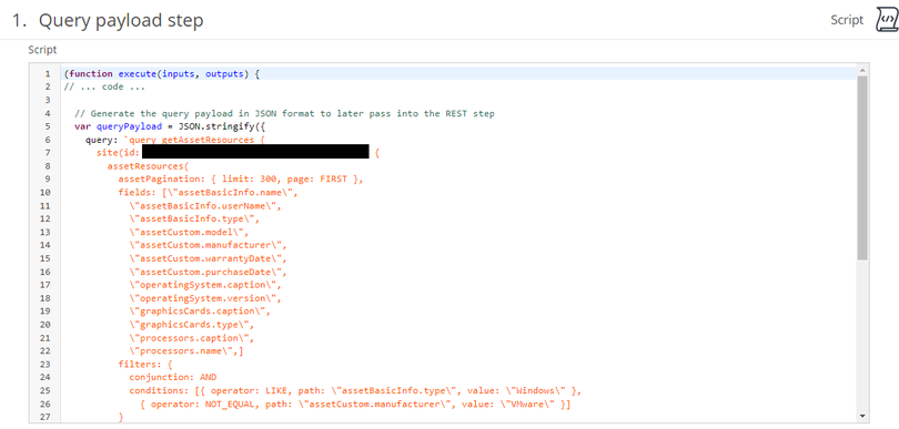

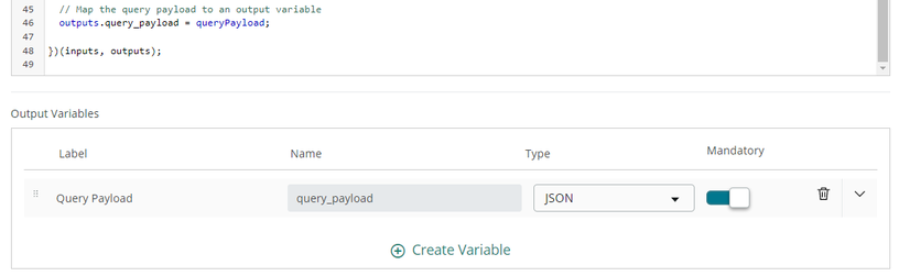

Ihor did this by turning his query into a JSON format ahead of time and pasting it into the Request Body. I did it slightly differently by creating a Script step before my REST step to transform my desired request into JSON format using the JavaScript JSON.stringify() method, then passed the data pill in as the request body.
