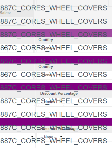

With this code, I am able to return 11 results and print 11 elements to the screen. The problem is that all 11 elements have the same values. Which is incorrect. These should be 11 different items. Here is a screenshot of what I'm talking about...
Any ideas why it's not printing the correct values?

Hi Kenneth,
This is a simple problem. When you do the Array.push, you are pushing a GlideElement (an object) into the array. When you do gr.next(), the values in each of the GlideElements that make up the fields on the GlideRecord get updated, but the objects themselves stay the same.
Each time you push to that array, you are storing a reference to the GlideElement, not pushing the value it contains. When you then loop over the array, you are accessing the GlideElement 11 times, and that GlideElement holds the value from the alst record you nexted to.
The solution is to use getValue('field_name'):
<g:evaluate var="jvar_core_choices" object="true">
var productArray = new Array();
var gr = new GlideRecord('u_product_line');
gr.orderBy('u_core_product');
gr.query();
while(gr.next()){
          productArray.push(gr.getValue('u_core_product'));
productArray;
</g:evaluate>
<j:forEach items="${jvar_core_choices}" var="jvar_array_item">
    <h3>${jvar_array_item}</h3>
</j:forEach>
Now you are storing the value at each iteration, and your loop will show the correct values.

Kalaiarasan Pus
As stated above, using the getValue function should resolve it....
bernyalvarado
Hi Kenneth, Cory Seering explanation nails it.
Perhaps just to enrich this thread, doing a .toString() cast will also do the trick:
productArray.push(gr.u_core_product.toString());
