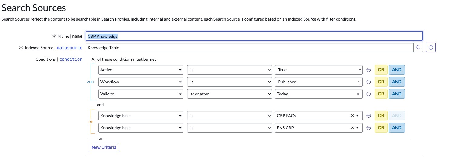

I had this same issue. Found that we were using AI Search. Went to this table "
ais_search_profile" found the search profile for my portal. Then in the related links in the "search sources" tab, there were condition on what articles could appear in the portal. Make sure the knowledge base your searching for in the portal is part of the condition.
