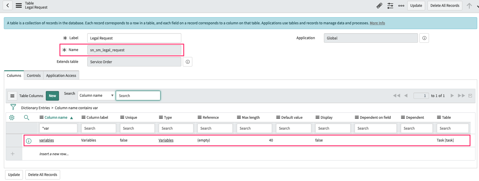

Where I'm coming up short is how to implement the "variables" field on a custom table (call it "finance_request"), so that Record Producers targeting finance_request can leverage the Variables Related List for questions/answers, in the same way as a "normal" Catalog Item, or one of the "real" Service Management plugin Record Producers (i.e. Finance, Legal, Marketing, etc).
I've noticed that when you create a custom table, the "Variables" field type is not available for use, seemingly making it impossible to implement this functionality on a custom table, without knowing some "trick".
Does anyone know what the criteria is for being able to create fields of the "Variables" type? And/or any documentation on this subject that might be helpful?
Examples below of 2 OOB tables that make use of the Variables field type. This seems to be the main missing ingredient for what we're trying to do. Everything else should be relatively straight-forward(ish).

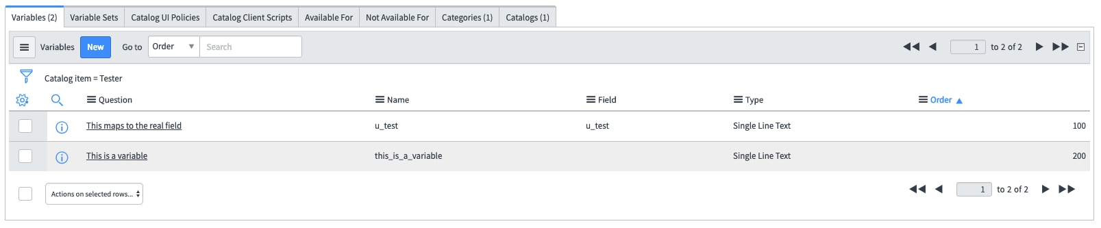

Thanks Mark. What is the purpose of the Variables field type then on the tables? e.g. as shown in the screenshots on my original post? (e.g. on sc_req_item).
As an example,

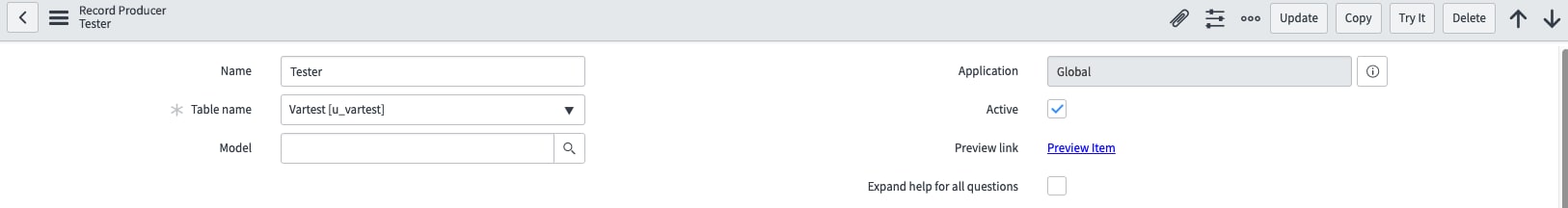

* I create a u_vartest table
* u_vartest has 1 field called u_test which is a String
* I then create a Record Producer called "Tester", target table u_vartest, with 2 variables:
---- "Some Text" - direct field mapping to u_test field
---- "Some Variable" - not a direct field mapping
* Via the Service Portal, I then submit a "Tester", filling in both fields
* A new record is created in u_vartest with the u_test field populated
* ...but, the data entered in "Some Variable" goes... where?
e.g. the following code:
var rs = new GlideRecord("u_vartest");
rs.addQuery("sys_id", "b5e5ceb537103300382b8cf6c3990e2d"); // THE RECORD THAT WAS CREATED
rs.query();
gs.log(rs.getRowCount());
if (rs.next()) {
gs.log(rs.u_test);
gs.log(rs.variables.this_is_a_variable); // THE NAME OF THE VARIABLE
OUTPUT:
*** Script: 1
*** Script: steve
*** Script: undefined
I'm fairly sure that not having a "variables" field on u_vartest is the issue - or at least part of it, but ServiceNow doesn't allow you to create a field of that type on custom tables?
Note - sc_item_option & sc_item_option_mtom tables remain empty after the above scenario.
