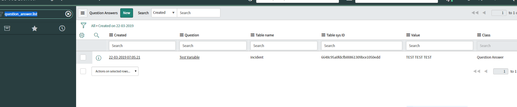

I did a small simulation of what you are trying to achieve. See below, hope this helps.
1) Created a Test Record Producer which could go against your custom table + 1 Variable.
2) After submitting the new Record Producer (thru for example the Service Portal), the store variable data is available in the question_answer table. The table sys id being the sys_id of the record created (in this case an incident).
3) By default, you will still see nothing on the form of your record. Also out of the box the case with incident. So I added the Variable Editor formatter to the Incident form lay-out.
4) And the result is here!
5) For your new custom table there won't be a UI Formatter. Though, you can easily create this. Just have a look at the out of the box formatters and duplicate one for your custom table.
