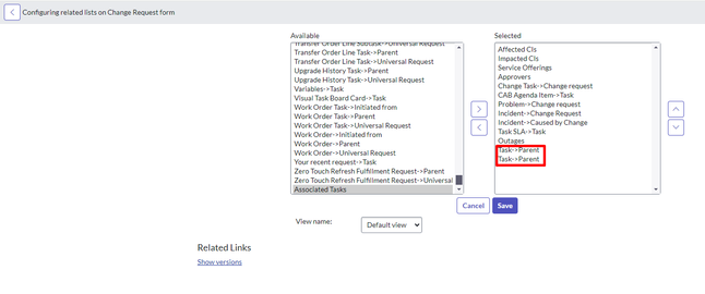

I have a requirement to create Associated Tasks as related list, that will link the Change Request with INC, REQ, RITM, SC TASK with Change Request. When INC, REQ, RITM, SC TASK is opened same Change Request to be added those.
How to achieve this?
Dr Atul - LNG
Sorry. seems confuisng for me. You want to link task or these records with change? You can link these records via related list on change form.
Ashutosh C J
Hi @Admin7267
Please do Configure > Related lists on change_request form and bring this
Try to add both one of them because one among them is for task table and the other one is for change tasks
You can remove once you find the right one

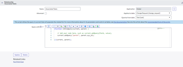

You can also use another method
System Definition > Relationships
Note - There is a parent field thats present on the task table that can be used to link the mentioned tables
