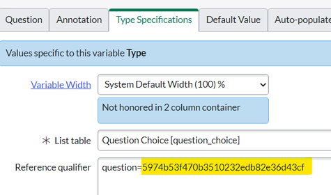

so I have a catalog item list collector that points to "Question Choice" table with a reference qualifier.
I assume that highlighted is the sys ID, but how can I find it just by having this info which question it is ??

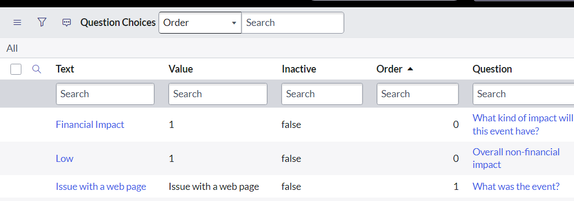

Hi @dev_K It seems your Question field is also a Reference field on your Question Choice (question_choice) table. Your attached image 2. Open that Question field in new tab and in List View. Apply filter using Funnel Icon Sys Id is

04-24-2024 12:15 AM
Hi @dev_K ,
Just go to table "question_choice" and apply filter sys_id is "sys_id for which you want question" then open that record you can see the question field that's the question.
if you want script for that here it is:-
var grQuestionChoice = new GlideRecord('question_choice');
grQuestionChoice.addQuery('sys_id','8aecb352c0a80015004a961f9d4e8252');
grQuestionChoice.query();
if(grQuestionChoice.next())
gs.print(grQuestionChoice.question.question_text);

04-24-2024 12:44 AM
Hi dev_K,
Copy the sys_id from the reference qualifier and in the Question Choices table apply the filter as "Sys ID" is and paste the sys_id and run the filter, you will be able to get the desired question.
