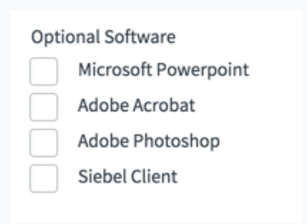

List collector variables point to reference tables. You can think of a list collector like a multi-select reference field. So if you change that field to a list collector, you'll have to specify the List table in the Type specifications tab of the variable record. If you don't have a Environment table already set up, you may want to consider using the checkbox variable type and creating a variable for each environment.
Here's an image of what the checkboxes look like:
