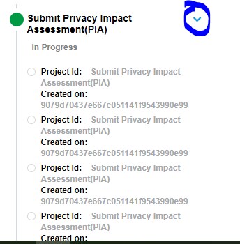

‎02-08-2019 06:06 AM
Below HTML will be added in left nav as shown
<div>
<label class="container" ng-repeat="task in data.iterativeTasks">
<div class="result-id">
<p>Project Id:</p>
<div class="result" ng-click='c.AddManualTask(task.catalog_id)'>{{task.name}}</div>
</div><br>
<p>Created on:</p>
</div>
<div class="result">{{task.catalog_id}}</div>
<input type="radio" checked="checked" name="radio">
<span class="checkmark"></span>
</label>
</div>
On click of Project Id it will go to another URL,
function($location) { /* widget controller */ var c = this;
c.AddManualTask = function(catalogID)
$location.url('snappi?id=fr_plan_details&sys_id='+catalogID+'&mode=new&dynamic=false&snappi_id='+c.data.snappiId+'+&phase_id='+c.data.phaseId);
After click the page is getting refreshed and becomes like this,
On the whole, subcategories are closed. My question is, how to stop refreshing the page after changing the URL.
Thanks in advance.
