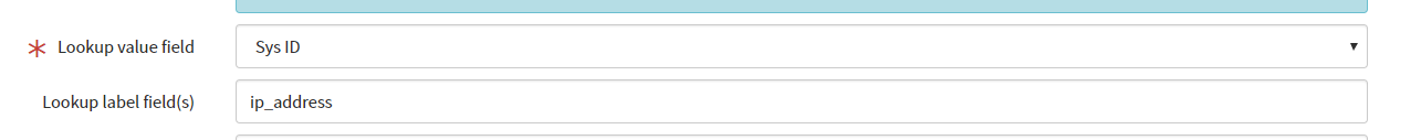

Set lookup value field as "SYS_ID"
and lookup lable field as a text display in select box.
The select box display as follows.Ip_address is text display and sys_id is value.
