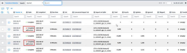

Output while transforming:
First two partitions (15k each) were transformed correctly but the other ones had completed with errors. I checked in the ISETs and the errors were the same: "Transaction cancelled: Available memory is almost depleted".
What can I check to define what is trully causing this error? Initially I was thinking that maybe the source file is somehow corrupted so I grabbed the last processed entry and couple of next ones and created a source file by hand counting that I could reproduce this error but with no luck.

DrewW
Have you tried to make the batch size smaller and/or import smaller chunks?
DrewW
MarcinM
Hello @DrewW ,
thanks a lot. Indeed setting Batch size to 2000 did the trick.
