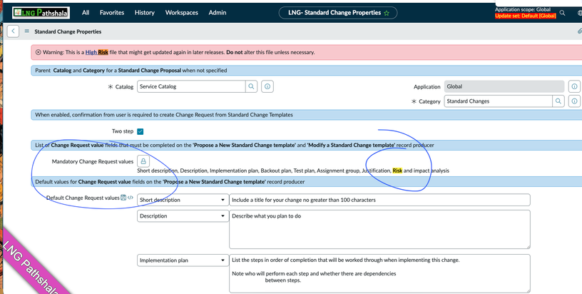

Dr Atul - LNG
Hi @ThiagoPereiraRJ
It might be conflicting with another property that makes it mandatory, so mandatory and read-only cannot work together.
Hi @Dr Atul - LNG
In the image you sent, the field marked as mandatory is [Risk and impact analysis].
In my case, they are two different fields: [risk] and [impact].
