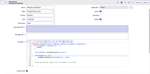

Hi @Kasia5 ,
You can create onChange catalog Client script and in that you can check the state value and based on that you can make your variable(field) as mandatory,
Please refer the below screen shot,
