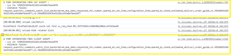

I tested this in a personal developer instance, using the default Form portal page and UI16.
When viewing an existing RITM, I can load the record in both UI16 and Portal and see the following results:
UI16:
Here, you can see the g_form has returned identical results between both the table level client script and the catalog level client script. The sys_id returned is the id of the Requested Item, and the Editable fields returned included both table level fields and variables.
In Portal:
Here you can see g_form is two separate instances, the table level script returns the correct sys_id, but getEditableFields() does not return any variables. The Catalog script returns the sys_id of the cat item record and has no relationship to the RITM. getEditableFields() is only returning variables and no table level fields.
In this case, I could still identify the RITM’s sys_id from URL params, but in the usage of the form I am using, the widget is embedded and does not use URL Params. Also the inconsistent results makes it difficult to identify editable fields. I have an active SN Support case as well, but the assistance from that end has been severally lackluster, and I have been pointed to other community articles which are unrelated to this issue. Hoping the community may have some ideas and thoughts on this!
Appreciate any feedback!

Thanks for the response Chris! By embedded widget, I mean our widget is embedded into a parent widget. This parent is designed to show more than 1 RITM, so there can be a couple, or more, instances of this widget embedded (think tabbed view). Because of this, the page does not use URL params since there can be more than one record on the page.
As of now, the response I have received back from SN support is this:
"The portal is primarily designed to enhance the requester's experience. Currently, it is returning null. We will discuss in the team whether to fix this or not. As a workaround, the customer can obtain the table name and sysID from the URL path parameters"
