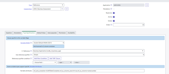

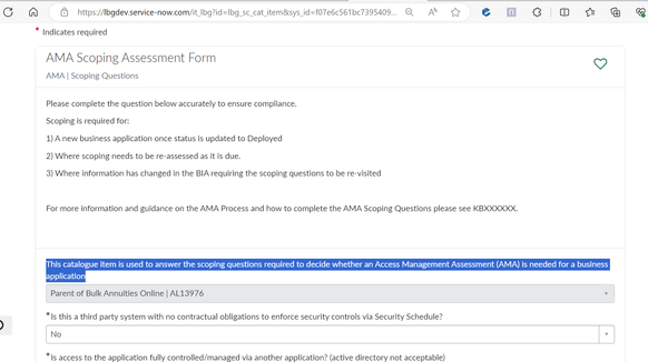

On a catalogue item, I've got a field called Business Application that only populates the name of the selected Business Application:
However, what I'm wanting to do is include the number of the Business Application next to the name, so it looks like the following:
This are the current details of my Business Application field:
Does anyone know what I need to change to include the Business Application number starting with AL

I've figured it out now. I changed the field type to Lookup Select Box

Testing the item:
That should do the trick.
