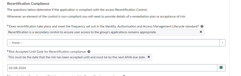

I've been working on a catalogue item that gets the values of it's variables from fields in a table.
One issue that I've noticed is that if a field from a table is a boolean and is left unchecked, ServiceNow assumes that this is set to False and it makes the fields on the catalogue item set to No, Even though I've set the unwanted field to hide, it still gets populated, leaving unwanted fields to appear.
However, this is incorrect because the details might not have been filled in properly by a user. What I'm wanting it to do is check that if the previous field had been populated. If the previous field has been populated, set it to No, otherwise, set it to Null.

Currently happening:
What should happen:
