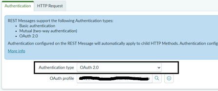

Hello @roronoa ,
Are you using Basic Auth or Auth 2.0 ?
Also send the screenshot of Outbound rest message configuration ..

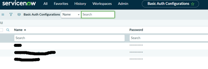

plz make ensure that you have properly configured basic auth profile in sys_auth_profile_basic table :
I have tested in my instance and working proper with basic auth :
