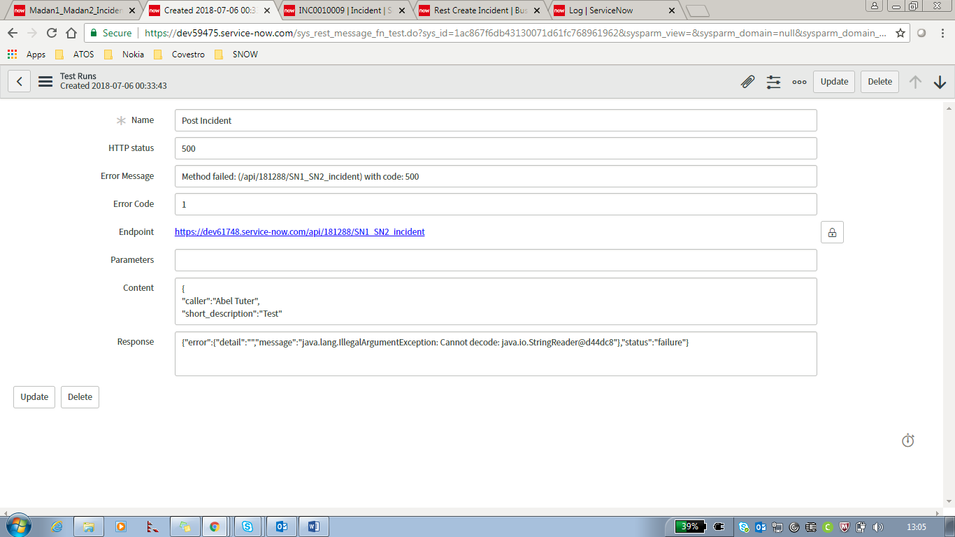

I am trying to integrate SN1 to SN2 using scripted Rest.
When i try to test the outbound from SN1 i am getting an 500 error code. Below is the screen shot.
When i use REST API Explorer in SN2 to create incident, it is working fine.
I assume there may be an issue in my outbound rest message.
Please help me on this.
Maddy
Kamal17
Hi Maddy,
You should be using some user account to establish connection from SN1 to SN2. Have you given necessary roles to that user account?
If not try assigning 'web_service_admin' role to the user account and then use it with correct credentials to connect from SN1 to SN2.
Udhay
Hi Udhay,
I have created a new user and provided ITIL and web service admin role to him already.
And i used Basic Authentication and used new user.
Maddy
