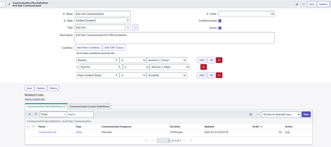

I have created communication plan definition For MIM Workbench and  have put condition as shown below
But it is not getting attached after i promote incident to major incident and accept that as a major incident
Please help me how can i fix this issue

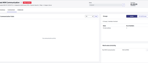

Not working means, if you can see on the SS which i have attached above there i have put condition like severity is 1 or major incident status is "accepted" so if these condition matched the communication plan get added on the MIM workbench under communication tab but that is not happening, the communication task is black as shown in Screen shot attached above.
