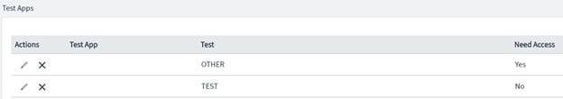

So I have a tricky Catalog Item/Workflow I am working on. I need to create and pre-populate a Multi-Row Variable Set (MRVS) from a data table we have in ServiceNow. Our ultimate goal is to have this display only on the Catalog Task that the Workflow creates once the Catalog Item is submitted, and to allow the Task assigners to fill it out, and we would like to take away the Add/Remove options from the MRVS, so all that they can do is edit the existing pre-populated records. But we are taking this bit-by-bit.
I have run into a problem with how the MRVS is being displayed in the Task. I have temporarily disabled my Catalog UI Policies which hide it from the Catalog Item on the Service Portal and from the RITM that gets created, to see if that helps. So right now, it shows in all three places.
Here is what it looks like on the Service Portal:
Here is what it looks like on the RITM:
And here is what it looks like on the Task:
As you can see, for some reason, the "Actions" title is being removed from the Header row on the Task, so all the Titles are shifted over one, and do not line up with the actual data.
Does anyone have any idea on what might be causing this behavior, or do you have any idea on how to correct it?

‎06-17-2020 11:36 AM
OK, so it turns out that there was an general Client Script that we had that was affecting this.
So we had to amend the Client Script which is running against the onLoad event of the Catalog Task table like this (this is just a portion of a much larger script in there that accounts for various exceptions):

‎06-16-2020 05:10 AM
Ankur,
I think you may have gotten off on a tangent, and the question I am trying to get answered has gotten lost in the shuffle. Granted, I still have some work to do with the buttons, but that is NOT the question I asked in this thread. Right now, my main concern is the question I asked and detailed in my original post, which is "Why is the "Actions" header being dropped when viewing the MRVS in Catalog Task?
As I showed in my original post, it looks fine when viewed in the Service Portal, and it looks fine when viewed on the RITM. But for some reason when viewing from the Catalog Task, the "Actions" header disappears, and all the other headers shift over, so the headers are above the wrong fields/variable (see the third image in my original post).
I am trying to figure out why that is happening, and how to correct it. Please, let's focus on that question.

‎06-16-2020 07:01 AM
Ankur,
So we are now trying to simplify this a bit. Instead of trying to create a Catalog Task with the MRVS on it, we are trying to just have the RITM (which we can assign to the group designated to work it).
So, when I go in to view the RITM as an Admin, the MRVS looks correct to me. It looks like this:
However, if I view it as a member of the group that it is assigned to, the RITM seems to have the exact same problem that my Catalog Task did. It does not show the "Actions" header, and slides all of the other headers to the left like this:
I am trying to prevent this from happening. It is odd that it looks correct when an Admin views it, but not when someone else does. What could be causing this?
