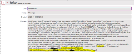

I have configured outbound email integration through outbound rest message. I am facing one issue here when I am passing 1 email id in cc it is working fine and receiving email but when I am giving two mail id in cc it is not working and giving below error.
At least one recipient is not valid., Recipient 'brijmohan.kushwaha@test.com,vipul.agnihotri@test.com' is not resolved. All recipients must be resolved before a message can be submitted."}}
I am assuming there is issue with JSON structure in BR (sys_email table). How can I handle multiple id in cc. PFB code.

gs.info("test 3 "+requestBody +JSON.stringify(requestBody));
restMessage.setRequestBody(JSON.stringify(requestBody));

In cc, I am already getting all email id but issue is when I am executing the code is it considering only one value. Can you please help me how can i modified below code as your suggested approach.
