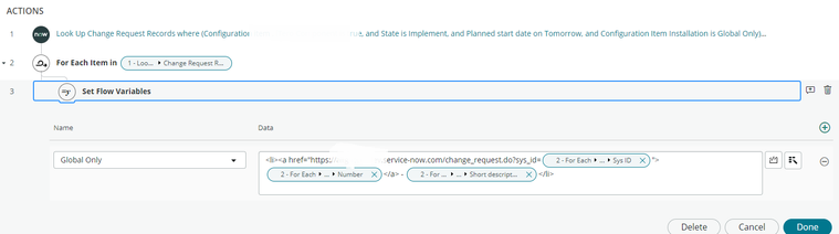

The requirement is I need to look up records of change request that will be deploy on tomorrow with some of conditions. Then it needs to generate the URL and short description for each record and POST to Microsoft Teams Channel.
What I am getting stuck is I am not sure how to consolidate the list of records of data.
I tried to look up records and set flow variables then post the message to Teams channel
Problem is once I could look up 4 records, it will update flow variables but it will overwrite each flow variables value, so I will get the data only the last record instead of all 4 records.

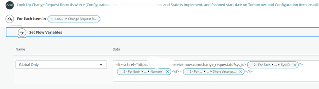

09-19-2023 08:50 AM
I got your idea but I really don't know how to achieve it.
As you can see in my picture, I need to print the hyperlink by getting the data (sys id and number) from 'For each' look up change request records.
How to append the flow variable for this case?
09-19-2023 09:01 AM
This can be done, within loop you can append the variable and outside loop you can use it.
