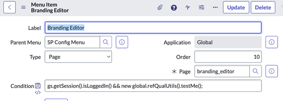

I got a chance to test a mock-up of this in my PDI, to make sure it works as I thought it should, and in short - it does. Here's what I did so you can see where yours might be different, or maybe try this simplified example. Something could be different jumping to pa dashboard...
I don't have many portal menus, so I modified the SP Config Menu (Service Portal Configuration in the left nav).  On the Branding Editor menu, I changed the Condition from the same .hasRole that the other menu items have to:
gs.getSession().isLoggedIn() && new global.refQualUtils().testMe();
Here's my simple Script Include, also in the Global scope, not Client callable:
var refQualUtils = Class.create();
refQualUtils.prototype = {
    initialize: function() {},
    testMe: function() {
        gs.info('BKB SI testMe function running');
        return false;
    type: 'refQualUtils'
I wanted to return false so that I would see when launching the page if it worked.  I cleared cache for good measure, then upon logging back in navigated to Service Portal Configuration.  The Branding Editor menu was hidden from the top menu.  I checked the System logs and saw my BKB SI message.  Make sure you have only one Script Include record named checkIfGroupMember.
