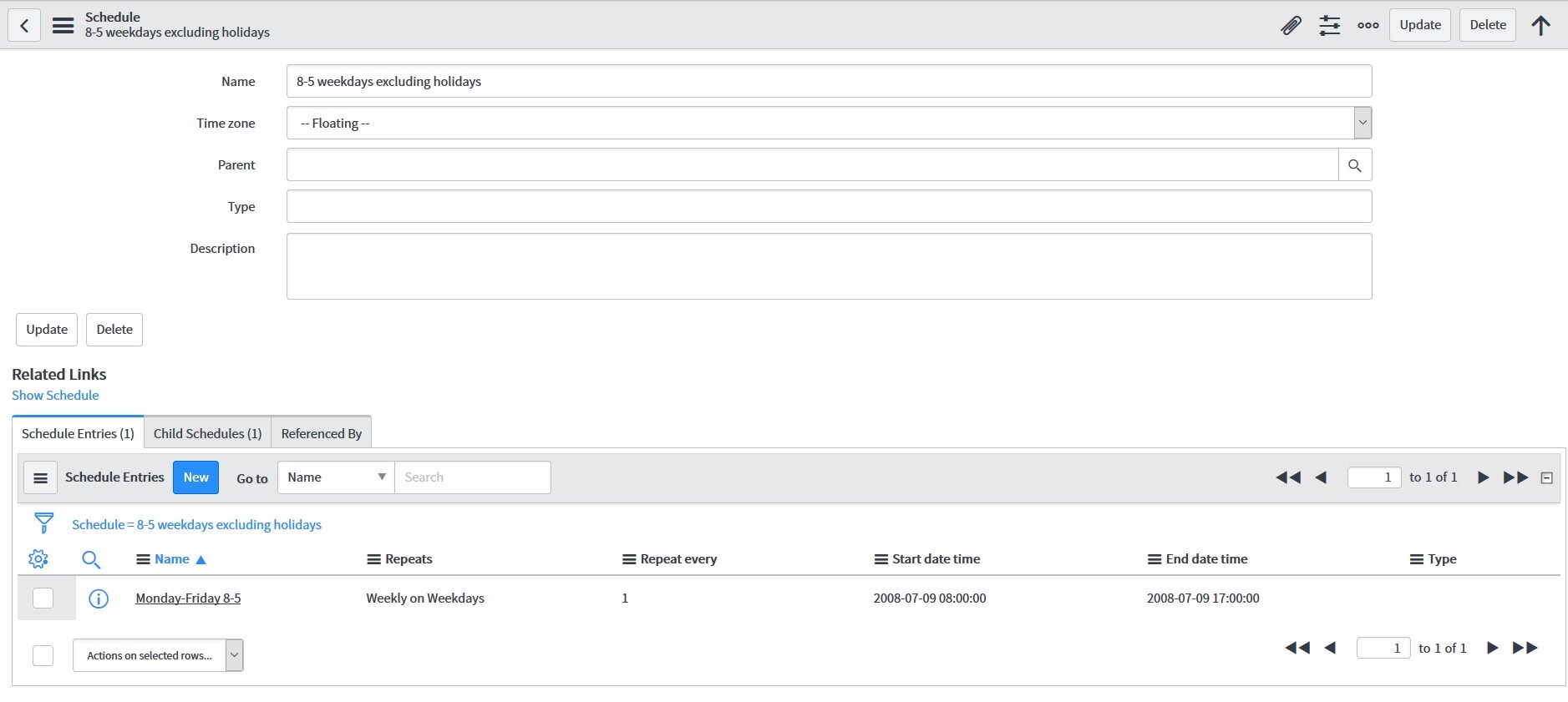

So I've been introduced to Schedules and have been working on it for last couple of days.
Here's the code am trying to run in a scheduled job that would submit a catalog item if the date in in schedule '8-5 weekdays excluding holidays'. Each time I pass a weekday or any day for that matter, it goes in the else clause. Any thoughts?
var schedRec = new GlideRecord('cmn_schedule');       // Query table for schedule
schedRec.get('name','8-5 weekdays excluding holidays');// Get the schedule name
var sched = new GlideSchedule(schedRec.sys_id);       // Create variable schedule
var schedTime = new GlideDateTime("09-14-2017 08:30:00");             // Create variable with current date/time
if (sched.isInSchedule(schedTime))
      gs.log('In schedule');
else
      gs.log('not in schedule');
From what I have understood, here the date passed is a weekday and hence should print 'In schedule' in the logs. But its not. Kindly advise.

this is might be happening with the time zone that you have selected in "8-5 weekdays excluding holidays" schedule. when i change it to floating then it is working and if i change it to some randomly canada/pacific time zone then it's returning also else part.
sk87
The timezone is floating in my case as well.The schedule entries have their Type as 'None' too. Not sure why its running fine in your case, but not mine.
