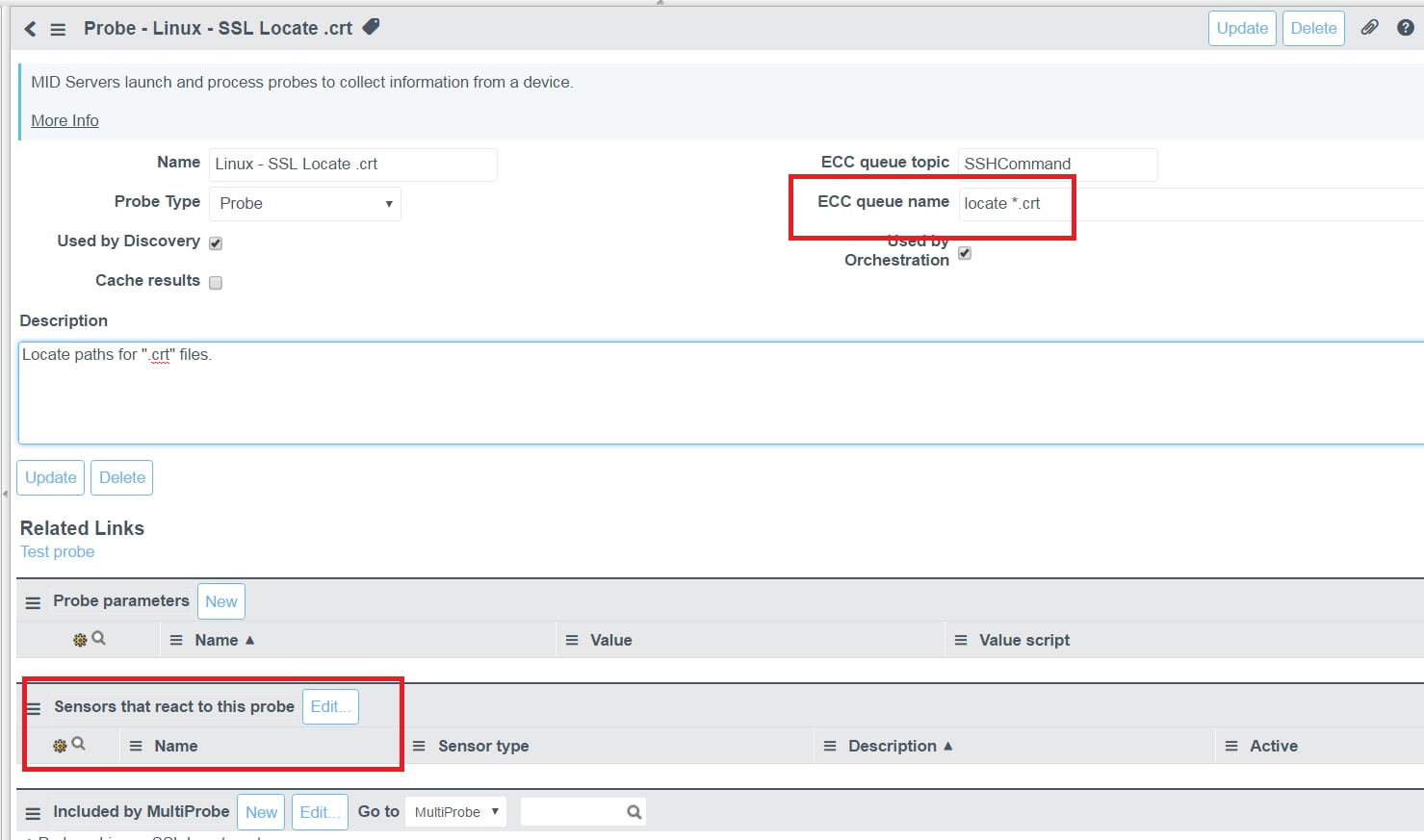

  1. to check for certs installed locally/internally on the server we would have to know where the certs install files are located, we can do this by creating a probe to capture all locations of where .crt files are located (if needed, we can create a sensor to parse through the output to capture all the installed locations of the .crt file to populate the CI but I did not complete this step but when you read through this write up, you can tweak the script i have to collect cert expiration date to meet this need):
    locate *.crt
  2. Once you get the output locations of where local certs are installed on the server, run this command while swapping out the files location with your own:
    openssl x509 -text -noout -in /etc/pki/tls/certs/localhost.crt

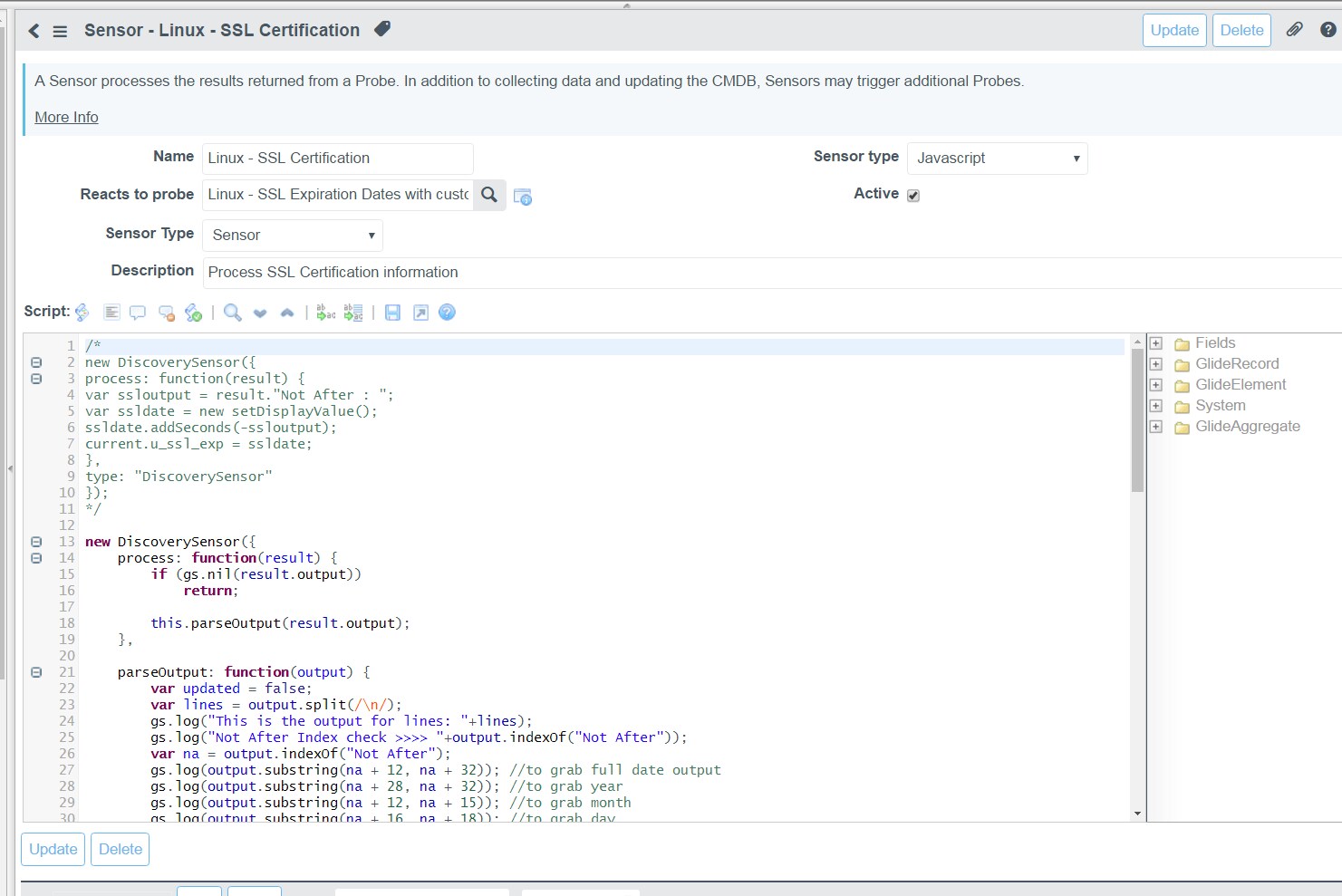

  3. After I created my probe, I then created the corresponding sensor to parse the output and relate them to the CI.
  4. I then created this java script for the sensor to parse through the output and grab the "End date" of the ssl cmd.

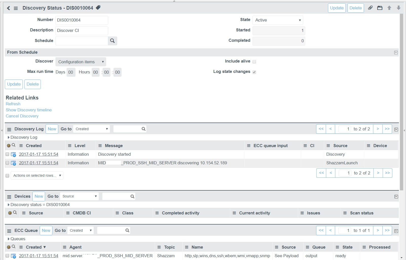

9. create a discovery schedule.
10. Scan will run, check with Discovery status, event logs, all (logs), script log statements, etc. to see status
11. Verify the CI field has been updated with the SSL expiration date:

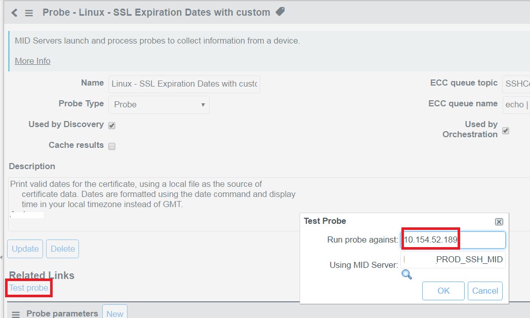

Here is the probe I created:
I have the following command I am running:

Here is the sensor code that I am trying to parse through the output and populate the respected CI with the target data being the "Not After :" date (which will be built out to have ServiceNow automate notifications when the expiration dates are close to approaching).
Here is the javascript to collect this information:

current.u_ssl_exp = ssldate;
type: "DiscoverySensor"
new DiscoverySensor({
      process: function(result) {
              if (gs.nil(result.output))
                      return;
              this.parseOutput(result.output);
      parseOutput: function(output) {
  var updated = false;
              var lines = output.split(/\n/);
  gs.log("This is the output for lines: "+lines);
  gs.log("Not After Index check >>>> "+output.indexOf("Not After"));
              var na = output.indexOf("Not After");
  gs.log(output.substring(na + 12, na + 32)); //to grab full date output
  gs.log(output.substring(na + 28, na + 32)); //to grab year
  gs.log(output.substring(na + 12, na + 15)); //to grab month
  gs.log(output.substring(na + 16, na + 18)); //to grab day
  gs.log(output.substring(na + 19, na + 27)); //to grab time
  var yyyy = output.substring(na + 28, na + 32);
  var mmm = output.substring(na + 12, na + 15);
  var dd = output.substring(na + 16, na + 18);
  var time = output.substring(na + 19, na + 27);
//convert cert output date to match servicenow date format.
  var mn;
  if (mmm == "Jan"){
  mn = "01";
  } else if(mmm == "Feb"){
  mn = "02";
  }else if(mmm == "Mar"){
  mn = "03";
  }else if(mmm == "Apr"){
  mn = "04";
  }else if(mmm == "May"){
  mn = "05";
  }else if(mmm == "Jun"){
  mn = "06";
  }else if(mmm == "Jul"){
  mn = "07";
  }else if(mmm == "Aug"){
  mn = "08";
  }else if(mmm == "Sep"){
  mn = "09";
  }else if(mmm == "Oct"){
  mn = "10";
  }else if(mmm == "Nov"){
  mn = "11";
  }else if(mmm == "Dec"){
  mn = "12";
  gs.log("This is the output for mn: "+mn);
  //gs.log(yyyy+"-"+mn+"-"+dd+" "+time);
  var sslexpdate = yyyy+"-"+mn+"-"+dd+" "+time;
  gs.log(sslexpdate);
  updated = true;
  if (updated) //Only update it if the output has good value
  current.u_ssl_exp = sslexpdate;
  //gs.log("The month number is "+mn);
  //for (var i = 0; i < lines.length; i++) {
                      //var line = lines[i];
  //gs.log("This is the output for line: "+line);
                      //var parts = line.split(":");
                      //var name = parts[0].trim();
                      //var value = parts[1].trim();
      //gs.log("Not After Index check >>>> "+output.indexOf("Not After"));
  //if (name == "Not After")
  //current.u_ssl_exp = value;
  //gs.log("The name is "+name+" and value is "+ value);
  //gs.log("The name is "+name+" and length is "+ name.length);
5. Take notice that I also had to convert the output of the SSL cert date to match servicenow's date format i.e. variables "mmm", "mn" (for month number), and rearranging the date.
6. Attach the sensor to the probe.
7. Test the probe to see if there are any errors to re-mediate.
i.e. of error
i.e. of working probe:
8.   For trouble shooting of the script you can make your way to   Script Log Statements to see how your sensor code is parsing through the output.
9. I then created the corresponding variable on the CI called "u_ssl_exp" that is referenced on line 75 of my sensor code.
