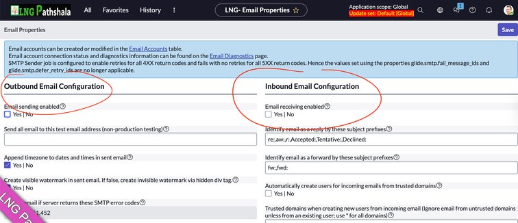

Hi @Abdul Please check if emails are enabled in the lower instance. Generally, email accounts and properties are disabled in lower environments to avoid any unintended communications.

Try sending a new test email from your email client to the target address with a simple subject and body easy to get this tested rather than wasting time why not working. Also, if you are going to send real email to lower instance then as mentioned by Atul do validate if email receiving is enabled.

1. Check if the Email properties is active or not.
