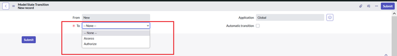

This is showing correctly on the change form. What is not working is I am not able to define the state transitions as state values itself are not available, as shown below:
Not able to select the target state value here . Please assist on what I am missing here.

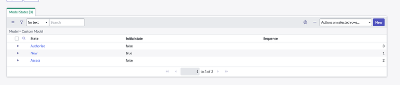

This is because you have only one model state record i.e 'new', you need to add all the model states first, then you would be able to see the target value. Refer to the screenshots below:
