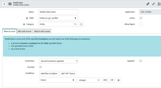

I could not see email logs for GRC notification "Notify Entity Owner" before November 2022, I could see the email logs from November 2022 and GRC users also reported the same that they are receiving notification from November month.
Even before November month I used to change the Owner of the Entity. Can someone help why I couldn't see the email logs before November month. I checked outbound, junk, failed, skipped and archived emails, no logs found there. No changes made in the notification it is in OOB version.
